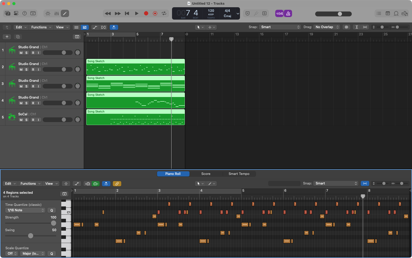

A capture opened in Logic Pro
The Song Sketch capture downloaded from Electra One and opened in Logic Pro: one track for each MIDI channel, and the notes in the piano roll

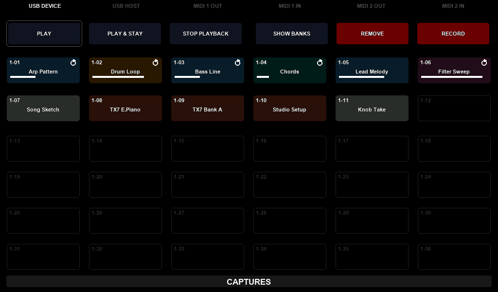

The CAPTURES window with captures playing
Electra One Mk2: six captures playing together. The bar under a name shows how far it has played, and the loop symbol marks the captures that repeat

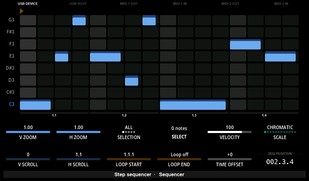

The Step Sequencer preset on Electra One Mk2
Electra One Mk2: the Step Sequencer preset editing the Arp Pattern capture while it plays
The Step Sequencer preset for Electra One Mk2 is an example of this. The pattern it edits is a capture.
