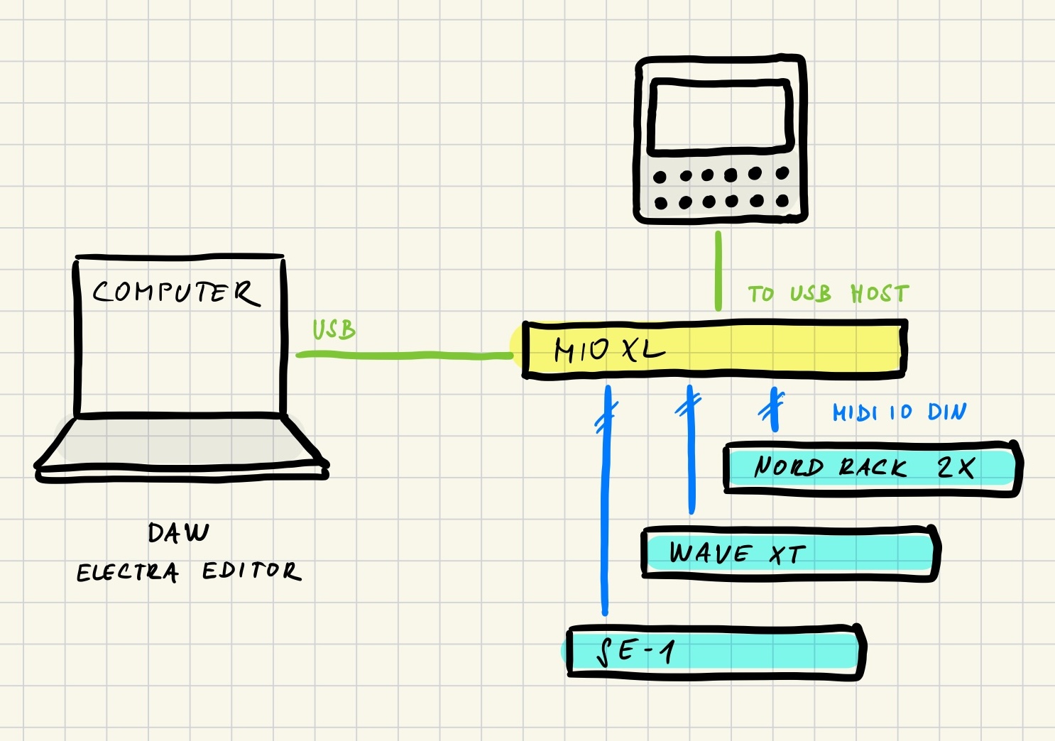

A diagram of connections: Diagram

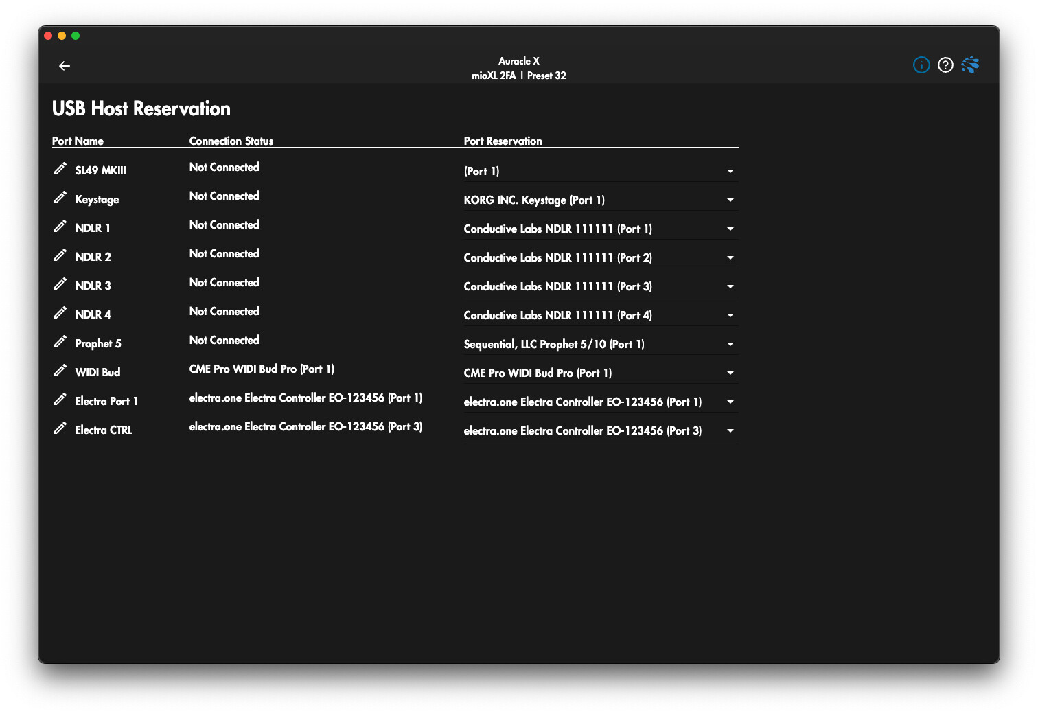

Once the controller is connected to the mioXL, open the Auracle software and navigate to the USB Host Reservation screen. There, select the HST ports you want to use, rename them as desired using the pencil icon, and use the dropdown lists to assign Electra One’s ports from the list of all available USB devices connected to the mioXL:
In this tutorial, we will configure Electra One’s Port 1 and CTRL port. The CTRL port is listed in the dropdown as (Port 3).

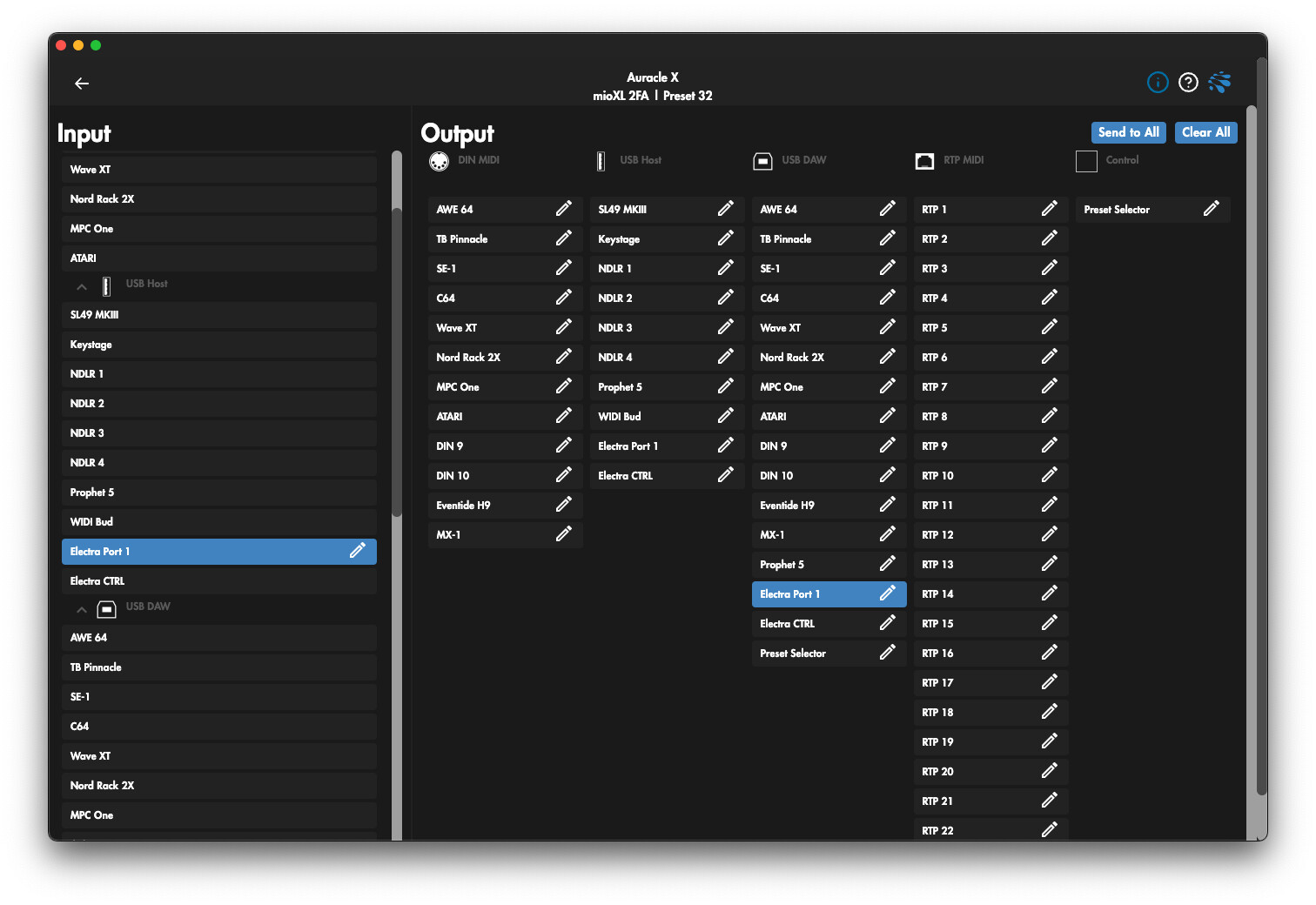

We will first set up routing so that the Electra One web-based editor can be used via the mioXL, and so that Electra’s Port 1 can be used as both input and output on the computer.
Overview of connections to set up:
  • USB Host Electra Port 1 -> USB DAW Electra Port 1
  • USB Host Electra CTRL -> USB DAW Electra CTRL
  • USB DAW Electra Port 1 -> USB Host Electra Port 1
  • USB DAW Electra CTRL -> USB Host Electra CTRL
In the Auracle software, use the MIDI Routing section to configure the required routes. While configuring the routes, edit the names of the USB DAW ports that you selected for the Electra One ports.
Required routes ​

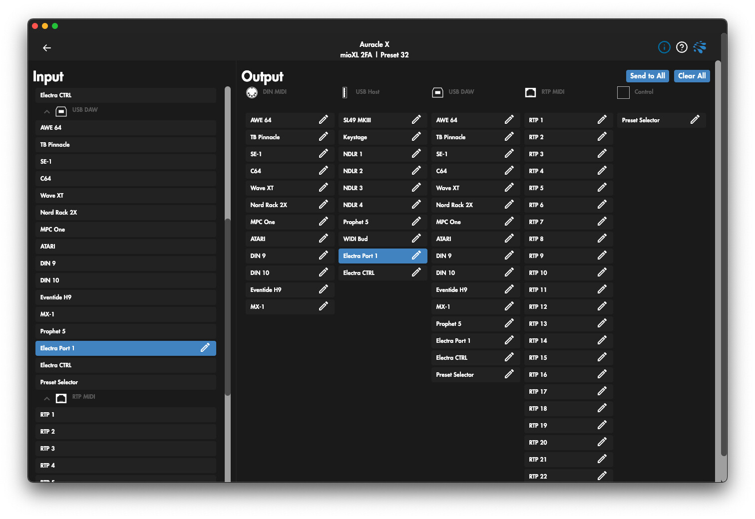

  1. From Electra One Port 1 to Electra Port 1 USB DAW on the computer. This port will appear on the computer as mioXL Electra Port 1 MIDI port.
    USB Host to DAW PORT 1

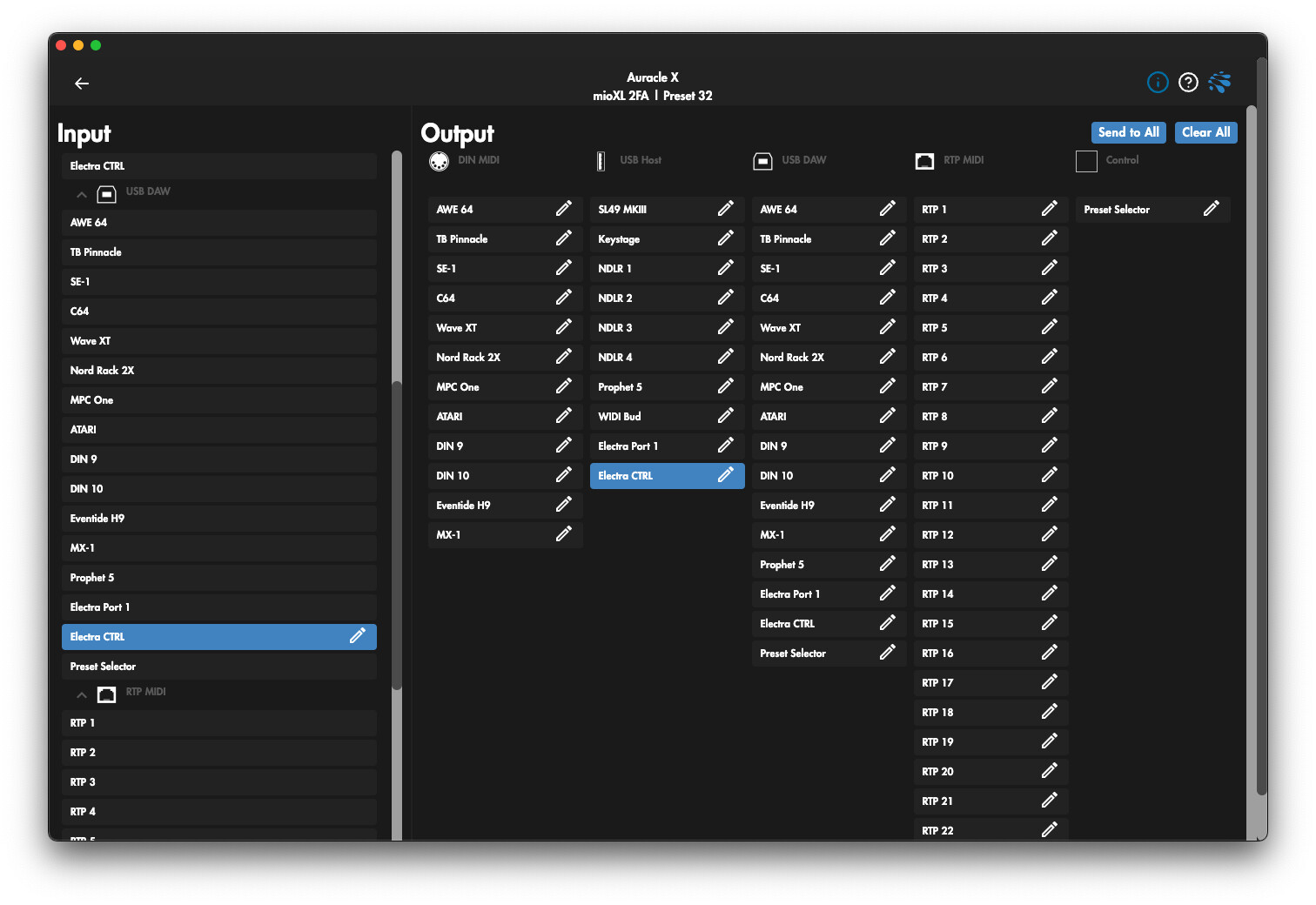

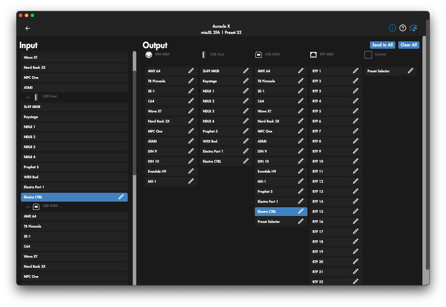

  2. From Electra One CTRL to Electra CTRL USB DAW on the computer. This port is used for the Electra web editor and will appear as mioXL Electra CTRL on the computer:
    USB Host to DAW CTRL
  3. Now, add routes for the opposite direction. Route mioXL Electra Port 1 to the controller's Port 1:
    DAW to USB Host Port 1
  4. And mioXL USB DAW Electra CTRL to the controller’s CTRL port:
    DAW ro USB Host CTRL

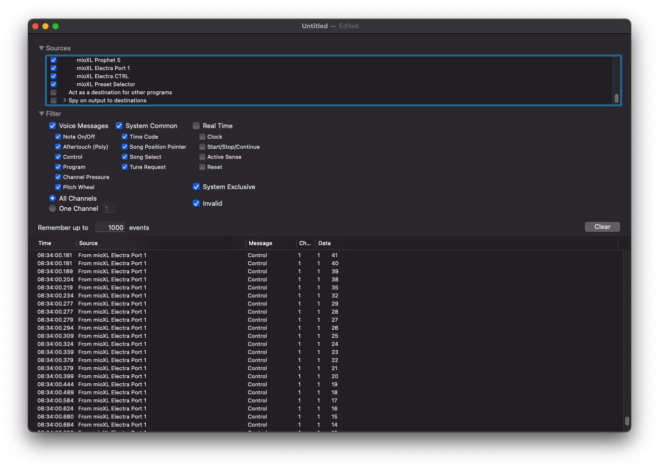

Use an application such as MIDI Monitor (on macOS) or MIDI-OX (on Windows) to ensure that the MIDI ports and their names are correctly set up.
If you have a preset loaded on your controller and you turn a knob with a parameter assigned, you should see the corresponding MIDI messages on the mioXL Electra Port 1 port on the computer.

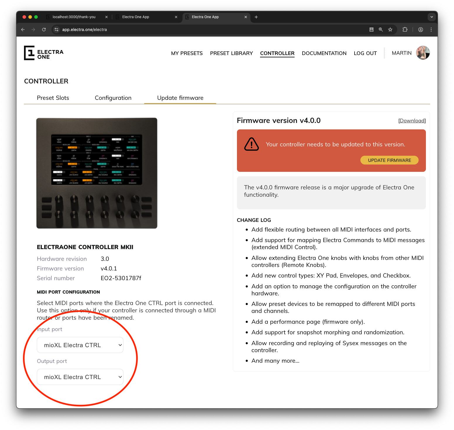

Open the app.electra.one web application, go to the CONTROLLER page and click MANUAL SETUP. Choose the router's Electra CTRL port, here mioXL Electra CTRL, as the Output port and as the Input port, then click LOOK FOR A CONTROLLER. The controller appears in the list, and the web editor talks to it through the router from now on.
Controller section
The MANUAL SETUP form on the Controller page, with the CTRL port chosen for output and input
Once set, try sending a preset to the controller. If everything is set up correctly, the preset should upload successfully.

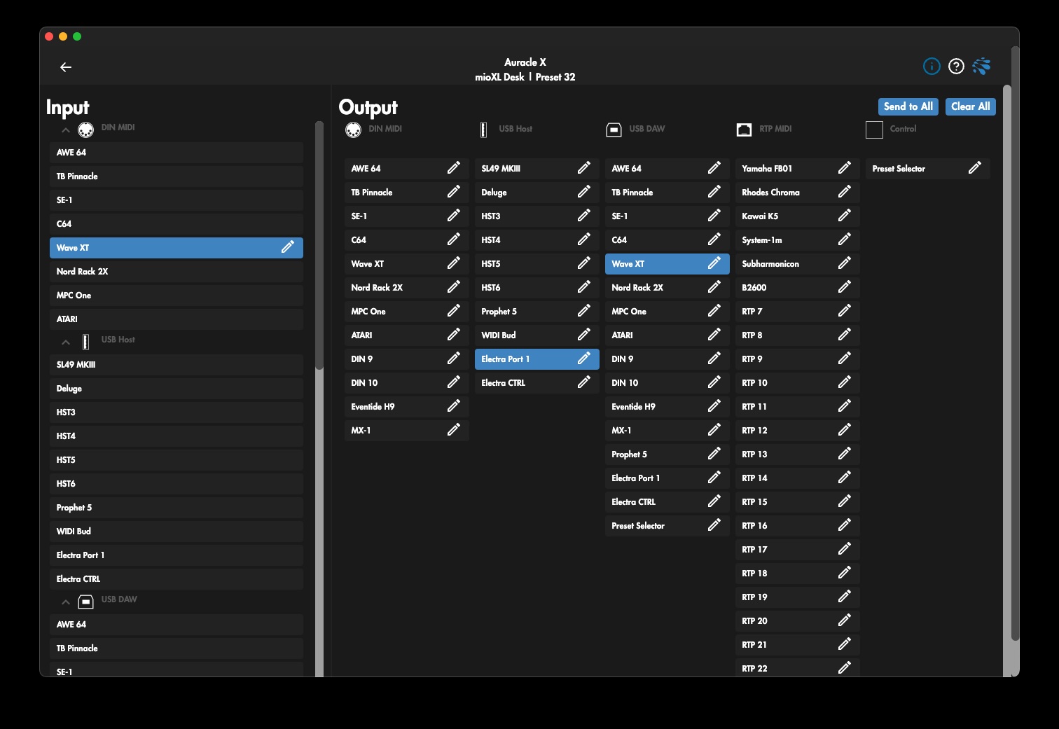

Let's describe and set up the required MIDI routes:

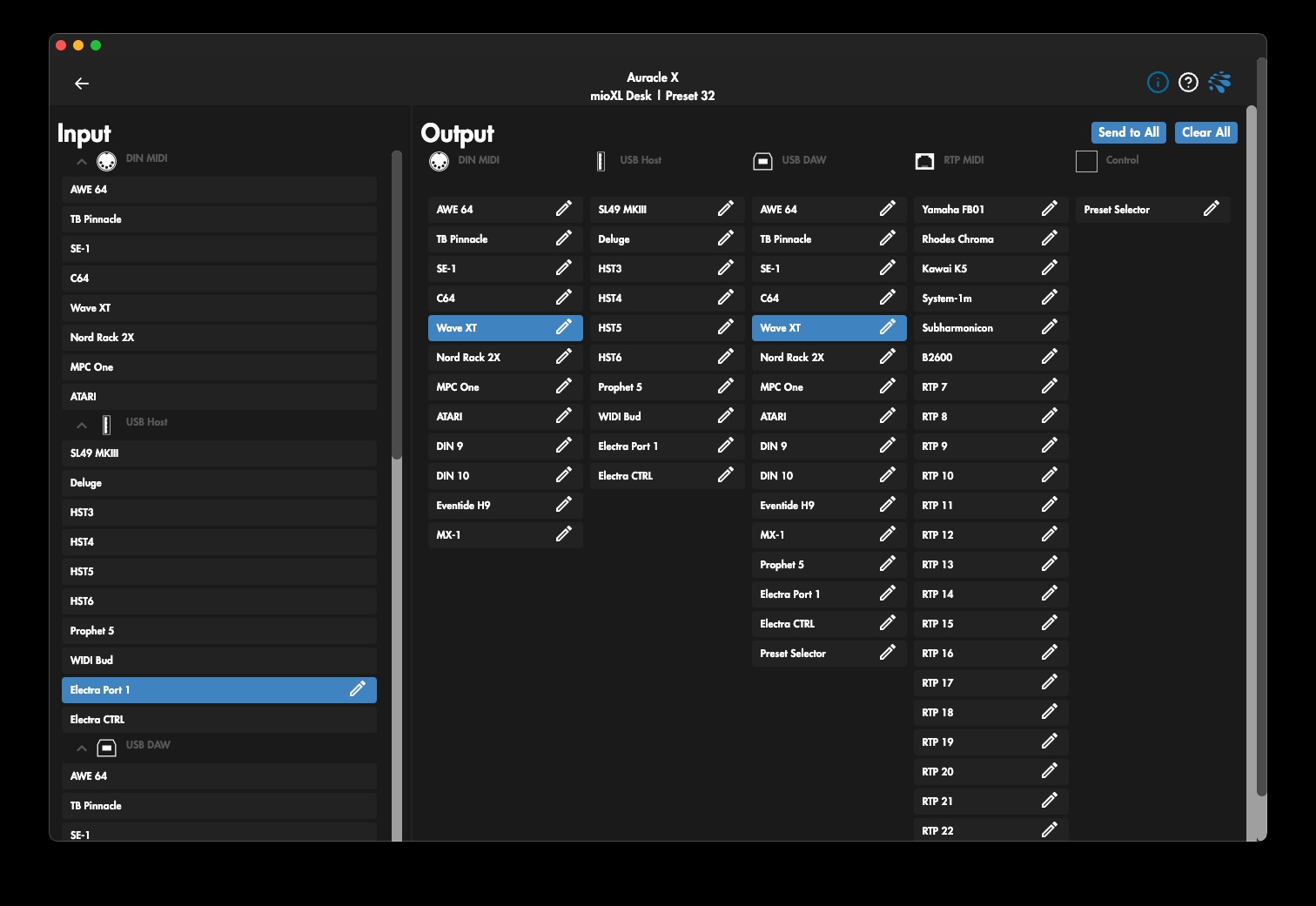

  • Messages from Electra One hardware controller Electra Port 1 on USB Host to be sent to:
    • Wave XT on the USB DAW port on the computer: This allows Electra One to send control parameters of the Waldorf Wave XT preset to the computer for recording of the automation.
    • Wave XT on the MIDI IO DIN port: This route provides direct control of the Waldorf Wave XT parameters with the Electra One.
    Electra USB Host
  • Messages from Waldorf Wave XT synthesizer on Wave XT port on the MIDI IO DIN to be sent to:
    • Wave XT port on the USB DAW port on the computer. This will allow recoring of changes (automations) amde with the knobs on the Waldorf Wave XT.
    • Electra One hardware controller on Electra Port 1 on the USB Host: This keeps the parameters on the controller in sync with the changes made on Waldorf Wave XT.
    Wave MIDI IO

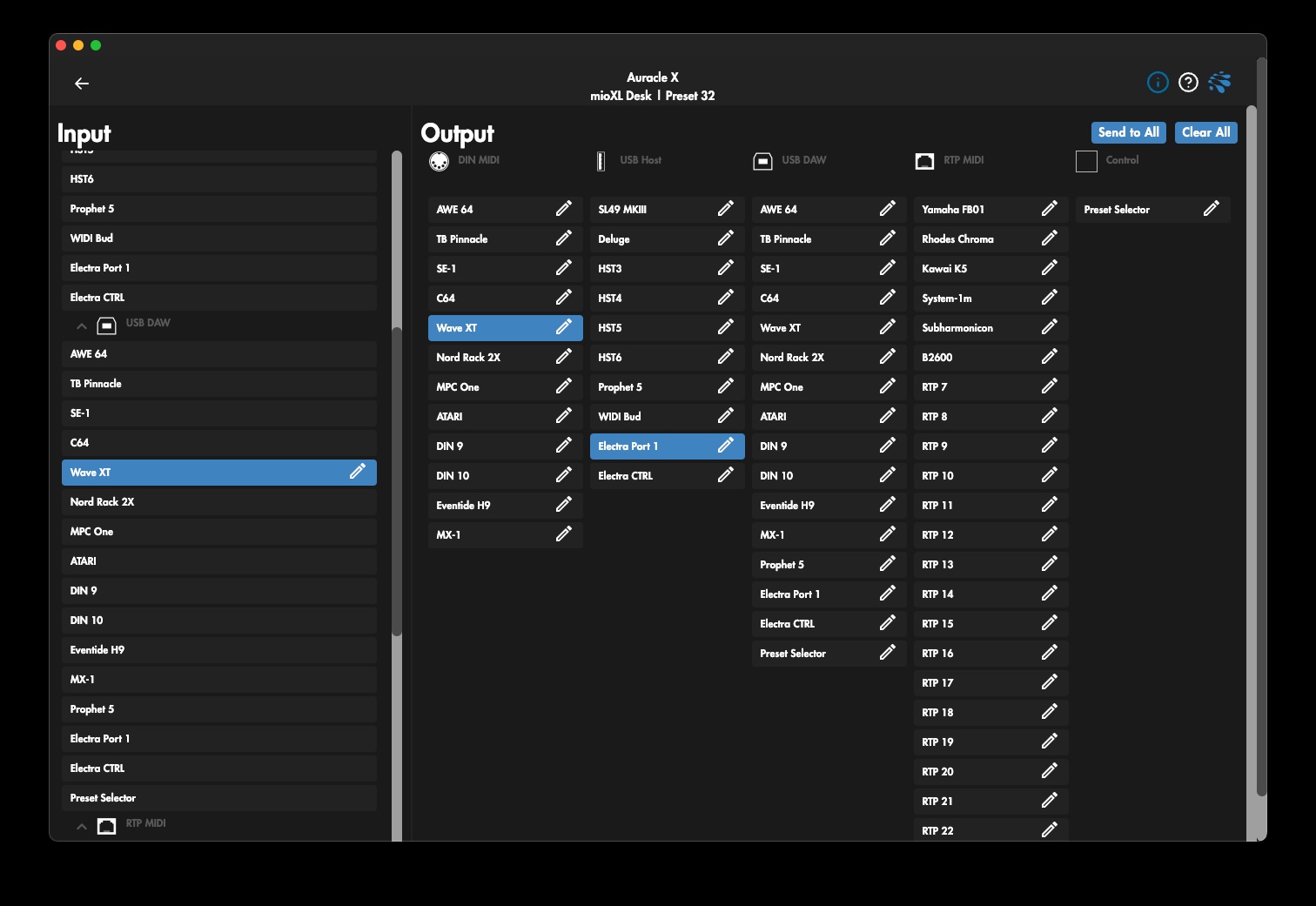

  • Messages from Wave XT on the USB DAW port on the computer to:
    • Wave XT port on MIDI IO DIN port: This route sends MIDI messages (including recorded automation) from the DAW back to the hardware synthesizer for playback.
    • Electra One hardware controller at Electra Port 1: This ensures that Electra One stays in sync with all parameter changes originating from the computer.
    Wave USB DAW
Use MIDI Monitor or MIDI-OX to test the new routes. If everything works as expected, don’t forget to save your preset.

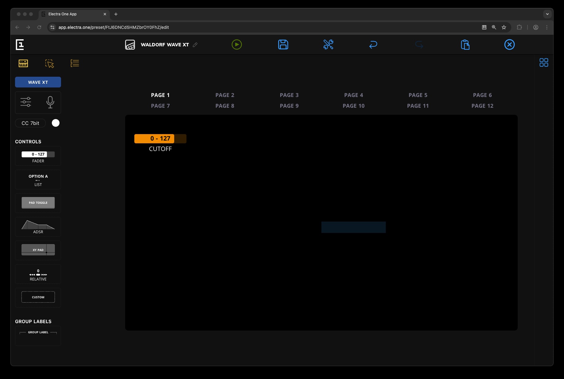

With all routing set up, it’s time to create or load a preset onto the controller. For this demonstration, we will use a simple preset with one control assigned to CC #50 – Filter Cutoff on the Waldorf Wave XT.
Preset
Note: It’s crucial to ensure that all MIDI channels are set up correctly. In this example, the Waldorf Wave XT is set to listen on MIDI channel 8.

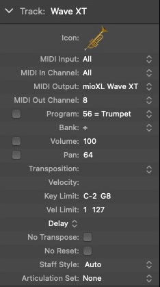

In our example, we will record from all MIDI inputs. This ensures that we also capture notes played by a software sequencer running on the computer. Setting the input to all MIDI sources guarantees that both sequencer data and MIDI messages from the mioXL Wave XT MIDI port are recorded.
We will set the input MIDI channel to 8. For the output, we will send everything to mioXL Wave XT port on the computer, MIDI channel 8:
Track settings

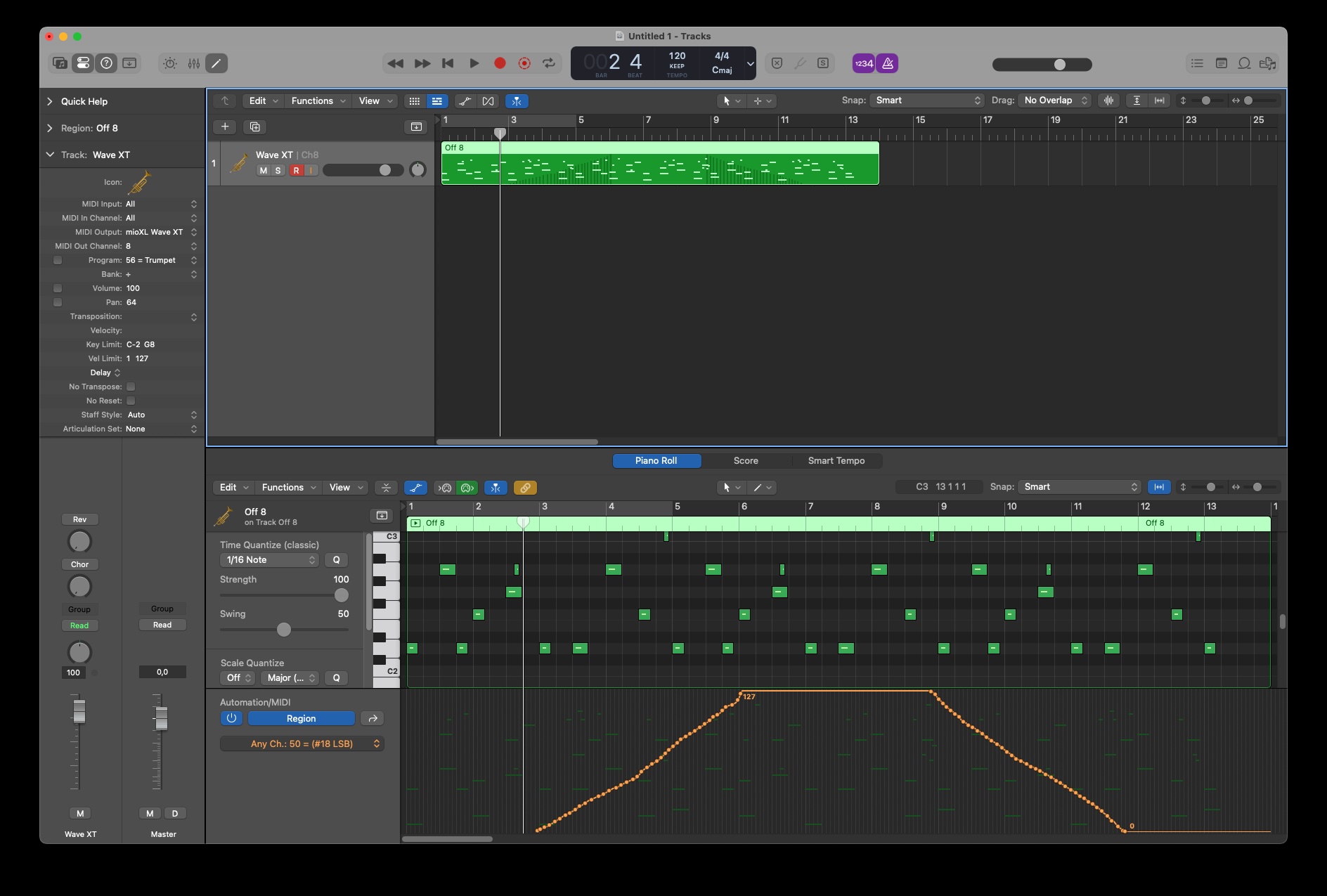

Below, there is the result of our recording. It includes notes from the sequencer and cutoff (CC #50) changes made using Electra One. If you also used the knobs on the Waldorf Wave XT, those changes would be recorded as well.
Recorded track
When this track is played back, all recorded data will be sent to the synthesizer, and Electra One will display all changes in real time.
