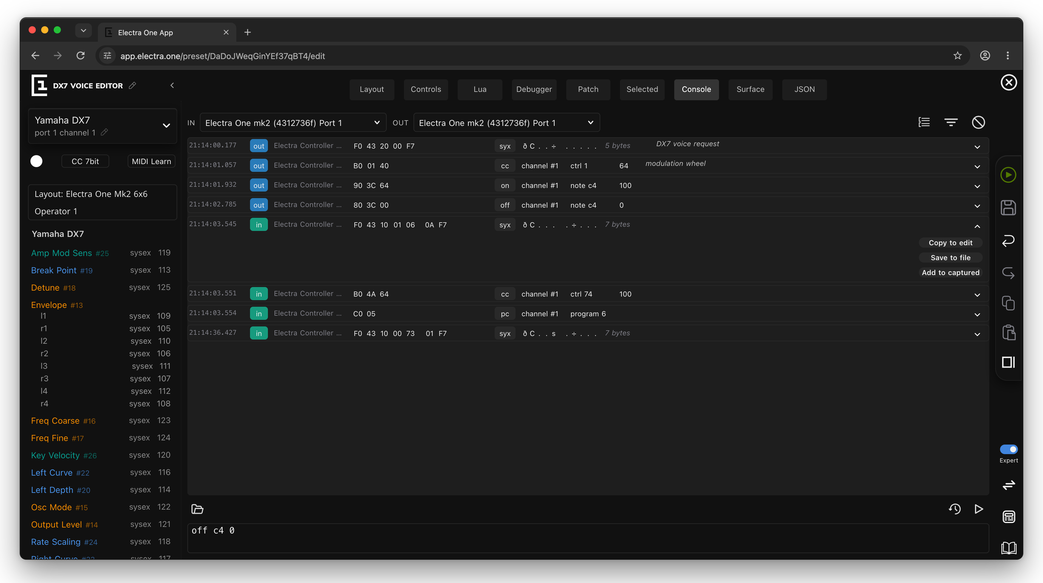

The MIDI console watches the MIDI messages that reach your computer and sends messages you type. It is a MIDI monitor built into the editor, like MIDI Monitor or MIDI-OX, and it is useful whenever you need to see what really goes over the wire: what a control sends to the computer, what an instrument answers, what a DAW receives.
The console is the Console tab of the editor, available in Basic and Expert mode. The same console opens in a window of its own from the Electra One Account: Controller menu, Midi console, shown while a controller is connected. The window keeps its own port choice and list, and has no Add to captured.
The MIDI console
Messages sent from the console (out) and received from Electra One (in), with the DX7 parameter change expanded

The message list ​
Each line is one message:
ColumnWhat it shows
timewhen the message arrived or was sent, to the millisecond
in / outreceived (green) or sent (blue)
portthe port it came from or went to
bytesthe message in hexadecimal
typecc, on, off, pc, pb, syx and so on
detailsthe channel, controller or note and value; for SysEx the text characters and the length
commentthe text after -- of a message you sent, or a description of Electra One's own messages
The list keeps the last 50 messages. Click the arrow at the end of a line to expand it:
  • Copy to edit puts the message's bytes into the command line, to change and send again.
  • Save to file saves the message's bytes as savedmessage.syx.
  • Add to captured (SysEx messages) adds the message to the captured messages of the Expert patch editor, to build mapping rules from it.

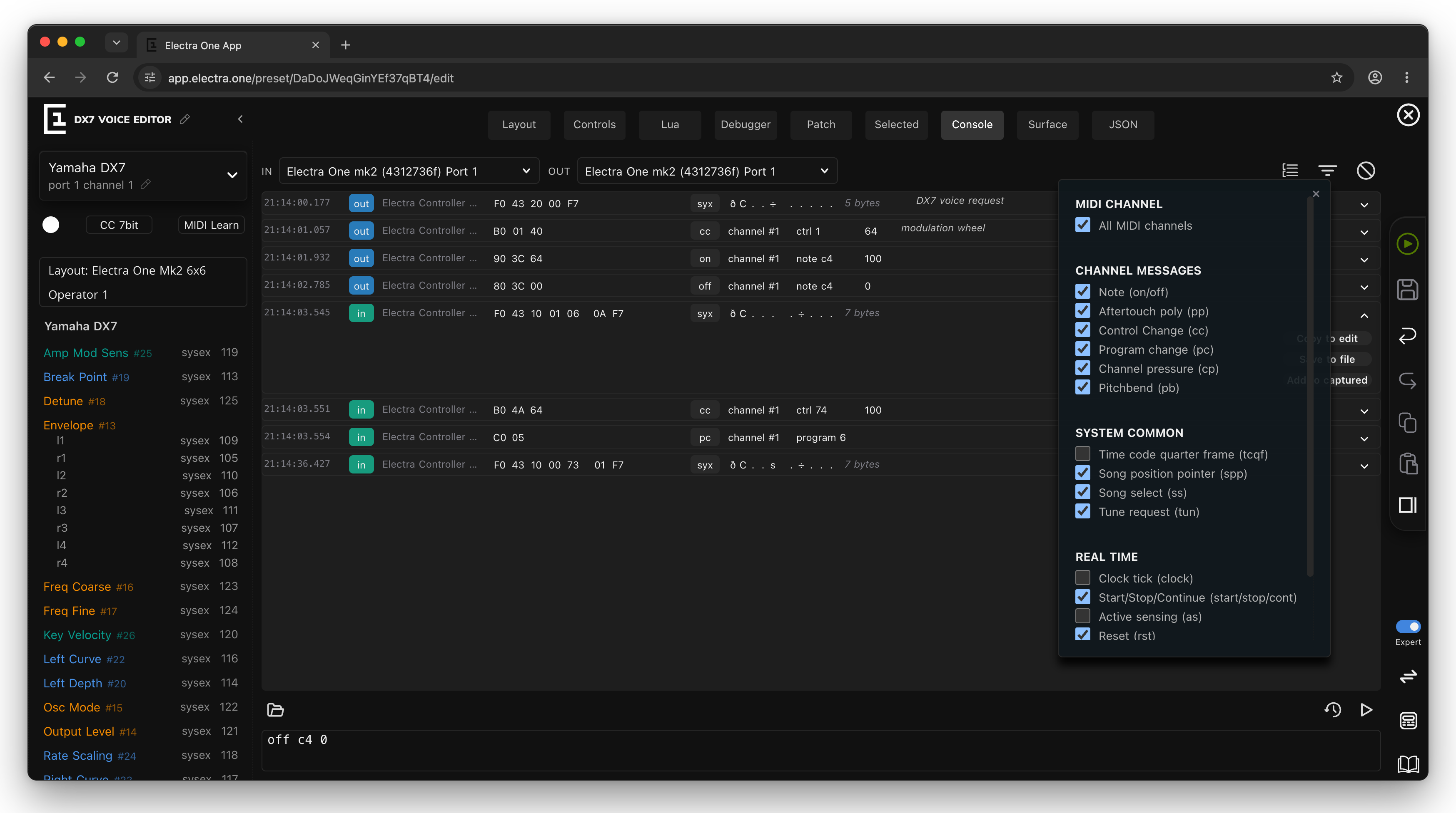

Filtering ​
The message filter
The filter: clock, active sensing and time code are hidden by default
The filter chooses which incoming messages the console keeps:
  • MIDI CHANNEL: All MIDI channels, or untick it and choose one channel.
  • CHANNEL MESSAGES: notes, poly aftertouch, control changes, program changes, channel pressure, pitch bend.
  • SYSTEM COMMON: time code, song position, song select, tune request.
  • REAL TIME: clock, start/stop/continue, active sensing, reset.
  • SYSTEM EXCLUSIVE: SysEx.
Clock, active sensing and time code are off by default: a DAW sends clock 24 times per beat, which would push everything else out of the list. The filter applies to messages as they arrive, and messages you send are always shown.
